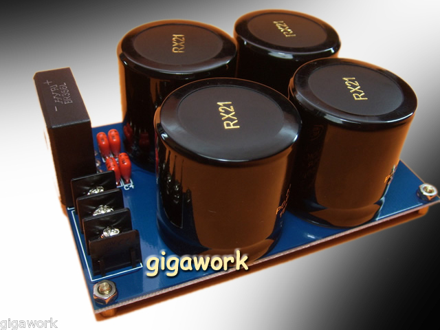

Stabilizatorius, tai čia power supply regulator? Maždaug toks?
http://i10.ebayimg.com/03/i/000/ff/52/5ce5_10.JPG
