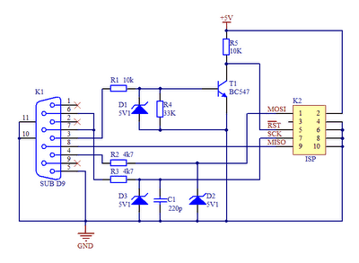

Sveiki, turiu atmega8 su usbasp softu ir atmega16 kaip ir tuscia. Atmega 16 nei su usbaspu neisiraso su avr burn o mat. o is usbaspo noriu pasidaryti kita programatoriu tai su tokiu http://www.embedds.com/wp-content/uploads/2010/10/RS232-AVR-ISP-SCHEMATIC.png programuoju. nei su pony progu nei atmegos 8 nei 16. gal kanors netaip darau?? Burnomat tuo COMiniu programinant nustacius ponyser (design ponyprog serial, reset=txd sck=rts mosi=dtr miso=cts raso: C:\Documents and Settings\Mosfet\Desktop\avrdude.exe -C C:\Documents and Settings\Mosfet\Desktop\avrdude.conf -p m8 -P com1 -c ponyser -F -u -U hfuse:w:0x4F:m -U lfuse:w:0xAF:m
avrdude.exe: AVR device not responding
avrdude.exe: initialization failed, rc=-1
avrdude.exe: AVR device initialized and ready to accept instructions
Reading | ################################################## | 100% 0.00s
avrdude.exe: Device signature = 0x000000
avrdude.exe: Yikes! Invalid device signature.
avrdude.exe: Expected signature for ATMEGA8 is 1E 93 07
avrdude.exe: reading input file "0x4F"
avrdude.exe: writing hfuse (1 bytes):
Writing | ***failed;
################################################## | 100% 0.09s
avrdude.exe: 1 bytes of hfuse written
avrdude.exe: verifying hfuse memory against 0x4F:
avrdude.exe: load data hfuse data from input file 0x4F:
avrdude.exe: input file 0x4F contains 1 bytes
avrdude.exe: reading on-chip hfuse data:
avrdude.exe: verifying ...
avrdude.exe: verification error, first mismatch at byte 0x0000
0x4f != 0x00
avrdude.exe: verification error; content mismatch
avrdude.exe done. Thank you.
padekit Smile
_________________
SPL in my blood...

galimai pamirsai pajungt isorini kvarca ar bent XTAL koja kuom nors pamajacint, nes avr skirtingai nuo pic po fuse programinimo tolesnei modifikacijai pasiduoda tik per HVisp
Visų pirmą patikrink atmeg'os maitinimą gal būt nėra pastovi įtampa arba neužteka jos, panašią problemą turėjau, kai užmaitindavau tik su 3.8V vietoj [4;5] V

na ji pas mane maitinasi per du diodus 3.6V kadangi programatorius tokiu principu veikia. Tai meginti jungti i +5?

pajungus +5 va taip gaunas
G:\WinAVR-20100110\bin\avrdude.exe -C G:\WinAVR-20100110\bin\avrdude.conf -p m8 -P com1 -c ponyser -D -F -u -U hfuse:w:0xCF:m -U lfuse:w:0xAF:m
Cia parasius -F ir -D

o kaip del kvarco ar betkokio kito xtal ?

http://prottoss.com/projects/AVR910.usb.prog/avr910_usb_programmer.htm padarytoj plokstej programinu, resetas ant MOD

Aš tai siūlyčiau paieškoti kompo su lpt ir pasinaudoti bent jau penkių laidukų programatoriumi.
Ps. - visai neseniai buvau nemaloniai nustebintas, kai usbtiny pareiškė kad atmega16 juo nesiprogramuoja. Teko pasinaudoti seno pigaus nešiojamo kompo paslaugom su lpt jungtimi ir avrisp programatoriumi.

Nebezinau ka daryti Sad Sad pasidariau toki:
http://www.scienceprog.com/avr-isp/ su 74hct244
ir gaunu toki rezultata.
C:\WinAVR-20090313\bin\avrdude.exe -C C:\WinAVR-20090313\bin\avrdude.conf -p m8 -P lpt2 -c blaster -F -u -U hfuse:w:0xD9:m -U lfuse:w:0xE1:m
Padekit patarkit prasau Smile

Beja su pony prog tai nors lemputes sumirgsi, o su BURN o MAT niekas. Pony prog isnkarto ismeta Device missing or unknown device

Jei lempute sumirksi, tai kaip suprantu maitinimą iš isp jungties programatorius gauna (tikiuosi maitinimą mikrei padavei? 10 koja minusas, 20 koja +5v iš antro isp kontakto). Tada bandyk pasižiūrėti per bios, kokį lpt režimą pasirinkęs. Jei neklystu, turėtų būti ecp+epp ar panašiai.

na maitinimas pajungtas gerai, Taip maitinima gauna is isp. Porto nustatymai yra tik auto bi directional, epp, ecp kad abu kartu nera. Kai paspaudziu read ar kanors panasaus. Tai kadangi atmega8 pajunga prie usb su visais kontaktais tai paraso usb device not recognized. Poto uzgesta lempute ir vel tiesiog unknown device. na o atmega16 taspat nesiprogramuoja nors tu ka Sad Sad Sad Sad

gal radai problemą ? nes pas mane ir prog su 74hct244 ir neveikia. pajungiu lpt ,įjungiu pony prog ,maitinima yra , probe paspaudžiu rašo ok . bet nei nuskaityt nei įrašyt nieko .
